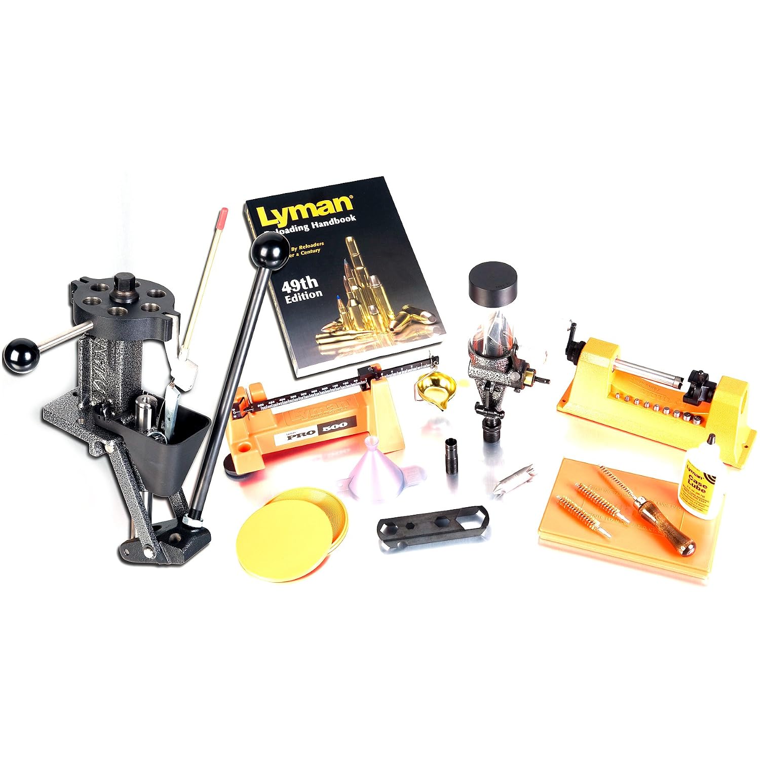

I like this kit from Lyman. It is a good wat to learn and make about the volume you want. If you want more volume, you will go progressive eventually, but this kit will still get used.
http://www.amazon.com/Lyman-T-Mag-Ma.../dp/B005I0KUZC
Personally, I prefer the beam scale, but the price is right here. An electronic scale usually can't be trickled into like you will likely do for your WSM.
That kit is here:
http://www.amazon.com/Lyman-Reloadin...6910851&sr=1-2
Nathan

I have the Lyman kit shown in post #7. I've had it almost 20 years. It's been a good kit to start with, nearly everything you need. The nice thing is you can do several steps on a given caliber without changing dies. Or leave the seating and crimping dies in place for a couple calibers to make it easier to switch back and forth. I've been very happy with it.

That does look solid. I like my Lyman turret but I do notice a small amount of flex on the turret when pressure is applied during decapping/resizing, and sometimes even during seating/crimping.

Lyman's T-Mag II turret press has an adjustable stem in back which allows you to limit flex to almost nothing. I don't try to resize .308 Winchester cases with the T-Mag II, but it's fine for expanding, seating and crimping any pistol cartridge IMHO.
